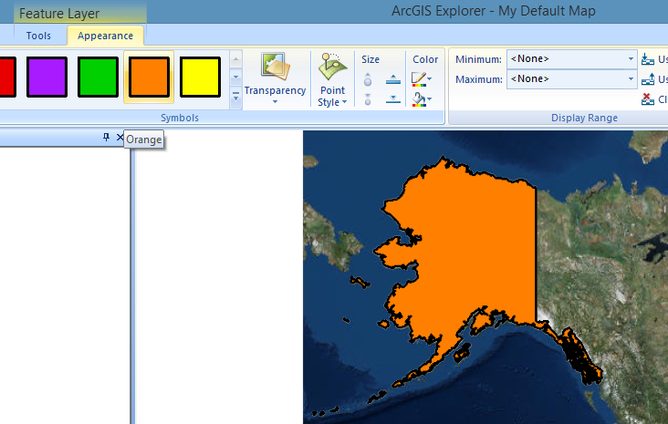

In regards to the shapefile drawing...  I can use this shapefile (US States) with no issues.
http://www.arcgis.com/home/item.html?id=0524dd696160428aa4b20917de67c500
When you initially add the shapefile it displays in a 50% transparent yellow color.  On the Appearance tab if you change the transparency to "opaque" (slide to bottom), does that make a difference?
If you then switch to a different color, does change?

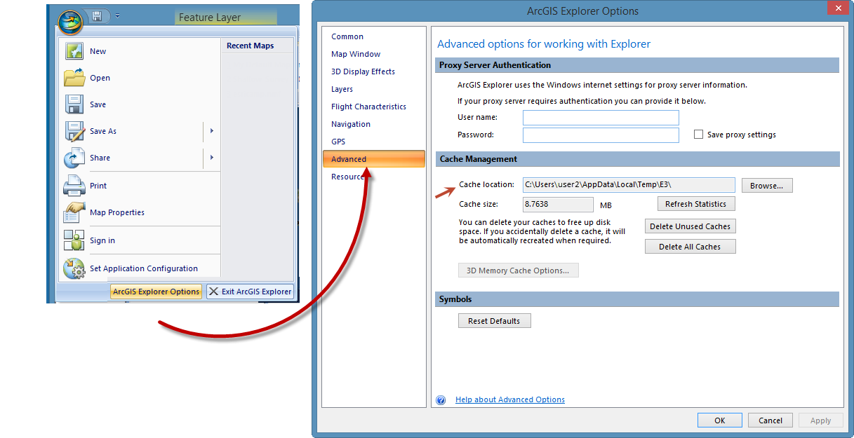

If there is still no display...   what is the cache path?
Speficically for your shapefile data, how long is the name in the table of contents?
If the cache path gets too long, it can cause drawing issues.  This length may have changed if you switched from XP to Win7, if all else stayed the same.
You could try setting the cache location to a short path.  ex: "c:\cache"
You did not mention this, but if you did install a newer version of ArcGIS Explorer, used it to view data, and then went back to an earlier version, the earlier version (depending on versions) will try and read the "newer' cache files and it won't be able to.  Deleting all of the cache files is the solution for this issue.
You also mentioned Admin vs. Non-admin users... You may be able to see a difference in the cache location between the two users..  Is the length different?  Can the non-admin user write to the cache location?

Thank you for all of the great information.  Lots to consider.  I too went down the cache folder path and it turns out for whatever reason, all of their installs had the cache folder set to the same administrator folder.  I'm thinking they installed AGX on an image and so the setting carried through every deployment.  They can figure it out from here.
