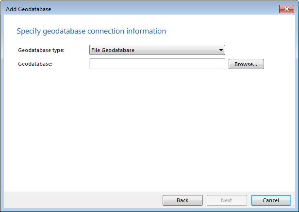

I'm trying to set up a configuration file in ArcGIS Explorer 2500 and have it connect to various servers automatically. In the configuration utility I click Add (see image) but it tells me I have to define the connections in ArcGIS Explorer. I guess there should already be connections in the box before I can connect to them automatically.
I've got lots of connections in ArcGIS Explorer but somehow they aren't getting recognized/-remembered so that the configuration utility can see them. I've tried this on a personal computer as well and the behavior is the same. So either I'm not doing this correctly or the program is not remembering them.
Anyone else have any luck saving ArcGIS Server connections in a configuration file? Thanks

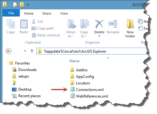

At 2500 some modifications to how things are handled in User Appdata profile introduced an error.  You can work around this by doing the following.
In your Windows File browser if you type in.
%appdata%\Local\ESRI\ArcGIS Explorer
You will see a Connections.xml file in this folder.
If you copy this file to %appdata%\Roaming\ESRI\arcgis explorer

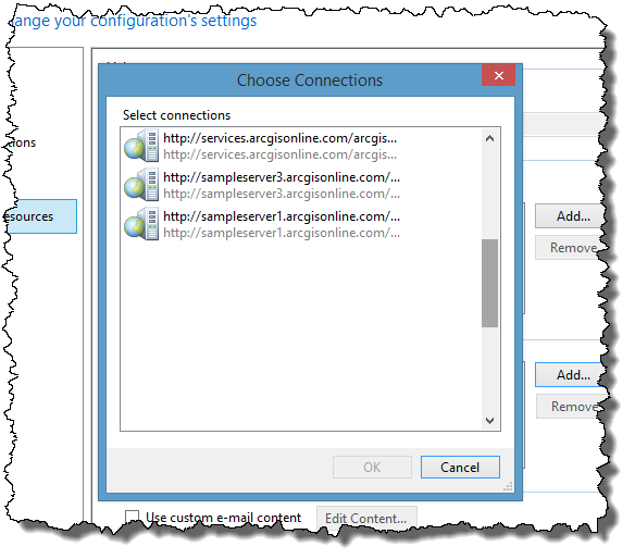

The Application Configuration Manager will be able to find the Explorer Connections xml file, and you will be able to add them to your application configuration.

I have not been able to reproduce the condition you are encountering.   After copying the connections file to the roaming folder, I have created application configurations with service and file geodatabase connection.   I have then successfully used them on separate machines.
I uploaded the application configuration here http://www.arcgis.com/home/item.html?id=780152ce0c5a447f844b4160c6f9a8a5
Do you see the connections when you use it?
