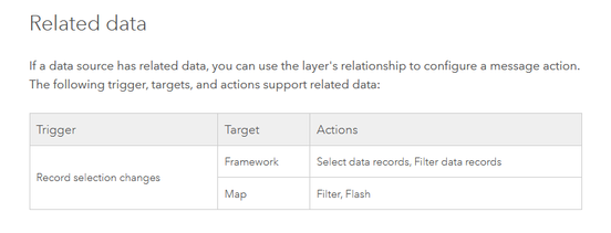

I can Flash and Filter the feature on the map via the related data but cannot zoom to  it ( even though the actions available in the Actions Tab are Export, Stats, Set filter, pan to, show on map, and Zoom to )

In Experience Builder, you can use Data Actions between layers to select / filter other layers based on a query or selection, but you're correct, you cannot zoom to it, as the geometry information is not on the "action" layer (the people).
The only way to really accomplish this in EB is to create a joined layer that includes the lot information / geometry as part of the related table, which is an awful lot of trouble just to get one thing to work.
