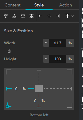

Hello everybody. I have a question related to Experience Builder. I'm developing an application, and when I change the resolution. for example: 1280 x 1024 to 1920 x 1080 the screen is misconfigured and I can't create an application that is compatible with different resolutions. Could someone help me to resolve this issue? Thank you for your attention and good work.

In the style tab of a widget's configuration, you can set the size and the spacing to be a fixed pixel value. I'm guessing yours is set to be a percentage?

GeoprocessamentoNovaLima
Thanks Josh for the information. I didn't know it was possible to fix the spacing. I tested it and the problem was solved. Thank you very much for your attention.
