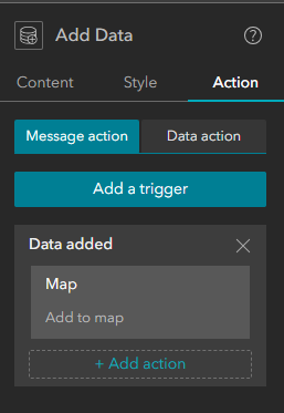

The data will automatically add itself after hitting Done if you configure an Data Added>Map>Add Data Action.
With the Add Data Widget in a Widget Controller, on future visits to the site the data will add itself automatically as soon as the widget is opened, until the layer is removed from the Add Data Widget or the user clears their cookies. I don't know what happens if its not in a Widget Controller.
