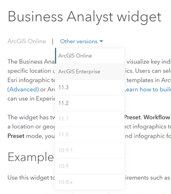

The help page has this version switcher, so you can switch to the relevant version of Enterprise.
