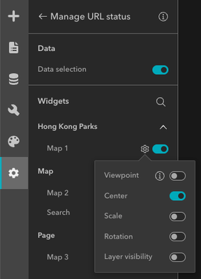

I'm afraid you cannot find the <mapWidgetID> from the builder. But there's way to find it at run time:
  • Go to Experience settings -> Manage URL status.
  • Turn on the toggle of the map widget that you wish to find <mapWidgetID> from. Make sure at least one option in the popper is enabled.
widget_1 is the <mapWidgetID> of this map widget. The reason that the <mapWidgetID> is not available
to users in the builder is that this ID is not very readable.

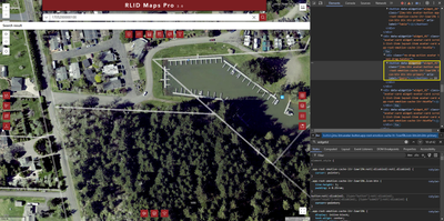

The method from @Shen_Zhang works, but it can be hard to find the correct widget in the URL if there are several listed. Here's another way...
Using the Developer Tools feature in the Chrome browser, you can search the page source and find "widgetid". The widget ID values will be to the right after the "=". The widget will also be highlighted on the web page and you can use that to figure out which widget has which ID.
