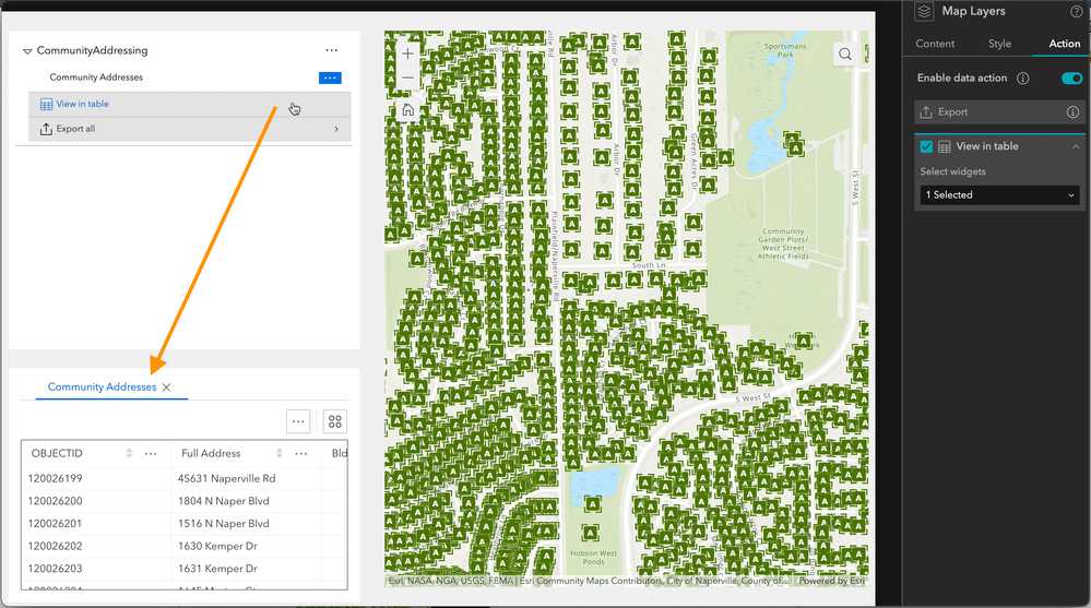

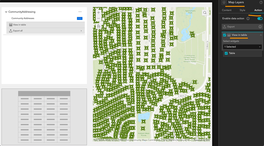

For your first question, it has been supported in the Map Layers widget:
https://doc.arcgis.com/en/experience-builder/latest/get-started/whats-new.htm
Try finding it in the View in Table data action configured in the Map Layers widget. One or more tables can be configured and you can add all layers in them:
