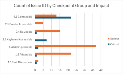

Grand Total128
And here's a horrible chart I made:
