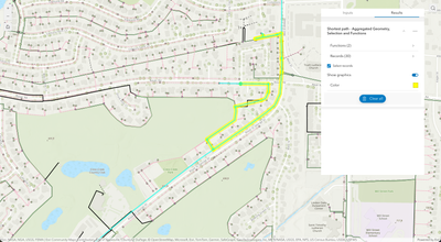

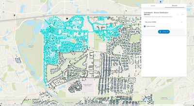

I did a couple of tests and didn't run into any issues:
1. Web map with UN, feature layers from local portal, and one feature layer from a second portal.
2. Web map with UN, feature layers from a second portal, and one feature layer from a third portal.
Note: All three portals used for these tests are 11.5.
Can you think of any additional information that could help us reproduce the issue you're experiencing on our end?
