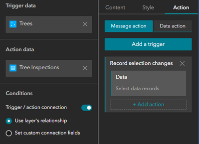

Have you configured a Message action between the Utility Network Trace widget and related layer data source, to select the related records when a trace is returned? Message actions only go one level deep, so you'll need to configure the action between the Utility Network Trace widget and the related layer itself, rather than between the Table widget and the related layer.
Message action example below (this is not utility network data):
Steps:
  1. Go to the Action panel in the Utility Network Trace widget settings
  2. Under Message action, click Add a trigger
  3. Select a target: Record selection changes
  4. Select a target: Framework / Data
  5. Select an action: Select data records
  6. Trigger data: the layer being selected by the Utility Network Trace widget when trace results are returned
  7. Action data: the related layer, related to the trigger data layer above
  8. Conditions: Use layer's relationship (note: you can also mimic relationships based on common field values)
