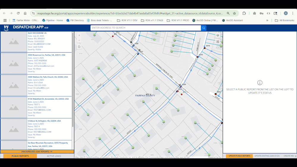

I can answer my own question and hopefully help someone else. I figured out I can use Javascript within an arcade expression. I use the below in a arcade element within a popup and it works exactly as I need it to:
var OID = $feature.OBJECTID
var url1 = 'https://myportal.com/portal/apps/experiencebuilder/experience/?draft=true&id=bxxxxxxxxxxf&page=LEAK-...'
 var btn =
'<div align="center">'
     + '<a href="'+ url1 + OID +'"style="background-color:#007BC1;;color:#ffffff;padding:10px; border-radius:10px;text-decoration:none;display:inline-block;text-align:center;"target="_self" onclick=\"window.open(this.href, "_self"); return false;\" >'
          +'<b>CREATE A NEW LEAK AT THIS ADDRESS</b>'
      +'</a>'
  +'</div>'
return {
  type : 'text',
  text : btn
This is how it looks. I need to refine this a bit to zoom the map into the same location but I’m on the right path…
