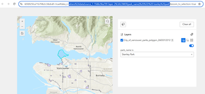

  • A simple way to write a where clause:
    Add a Select widget, configure a where clause, and then test it at runtime. You will see the where clause syntax in the URL.
