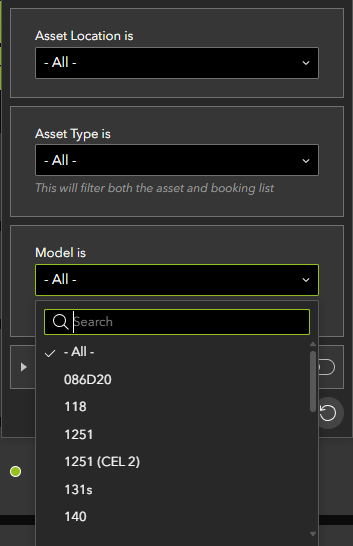

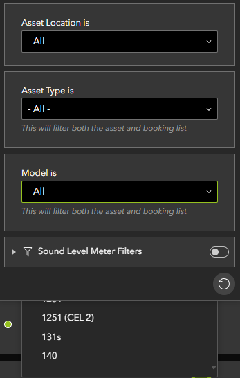

This is then causing issues with filters I have configured where the filter options appear behind the filter window like below.
If I remove the view parameter from the URL then the filter behaves as expected with the options appearing over the filter widget.

It's fairly niche but if you access the app and use the filter it should display as expected. However, if you then select the button which is linked to a view in a window and then close that window the filter will no longer display correctly. You can see that the URL maintains reference to the view despite the window being closed. If you delete this part of the URL, the filter behaves as expected. I also discovered that the filter worked fine unless the option arrangement style was changed to "icon". Like I said, niche but we hadn't seen this issue before the update so looks like something has changed.
