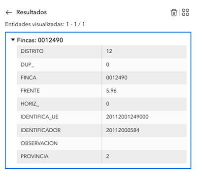

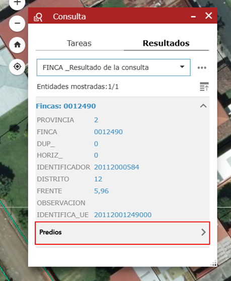

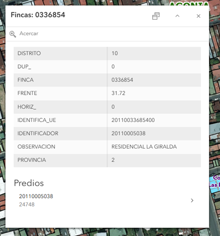

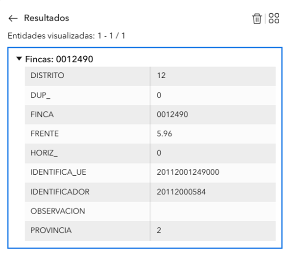

Do you know if it’s possible or how I can replicate the related data configuration from the Query widget in Web App Builder in Experience Builder?
Query Widget in Web App Builder:
Configuration in Map Viewer:
Query Widget in Experience Builder:
Thanks very much for the help
Laura
by MVP Regular Contributor

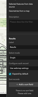

Personally I run into this bug when setting the results to use webmap settings: https://support.esri.com/en-us/bug/the-query-widget-in-arcgis-experience-builder-does-not-bug-000167...
If you customize rather than use webmap settings it doesn't look like you can add related records. Looks like you'll have to play with it so the query result opens your popup which has the related record.
