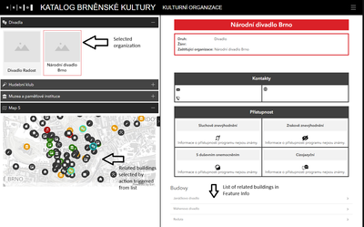

Now it is possible to show related records in pop-up. But when I open a Related record in pop-up (or Feature info widget) I still have in map selected a parent feature. So it doesn't match what I see in the map and pop-up.
Is it possible to synchronize it, for example with some trigger?

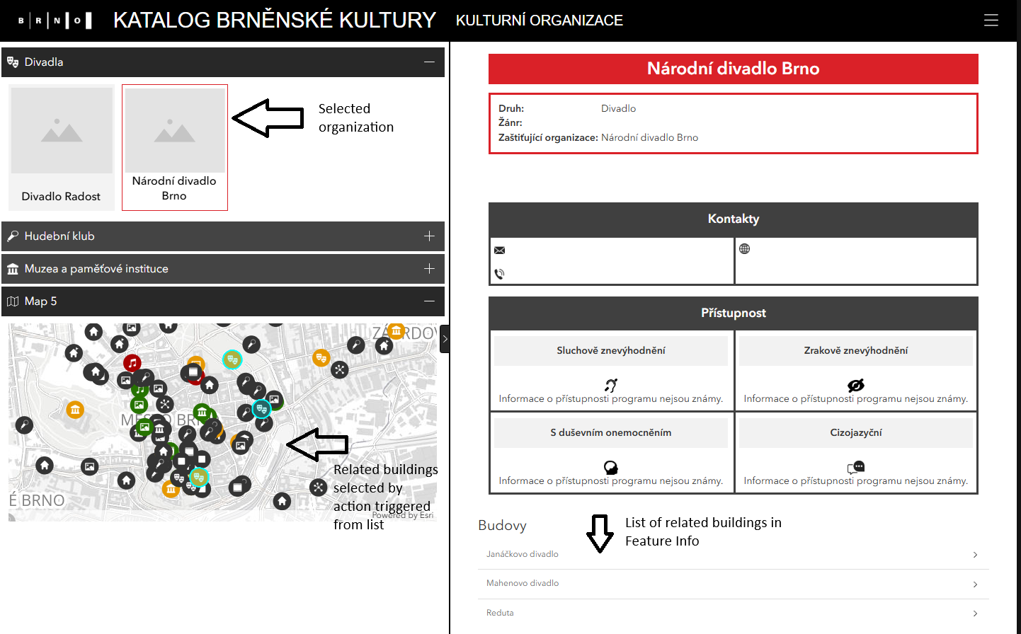

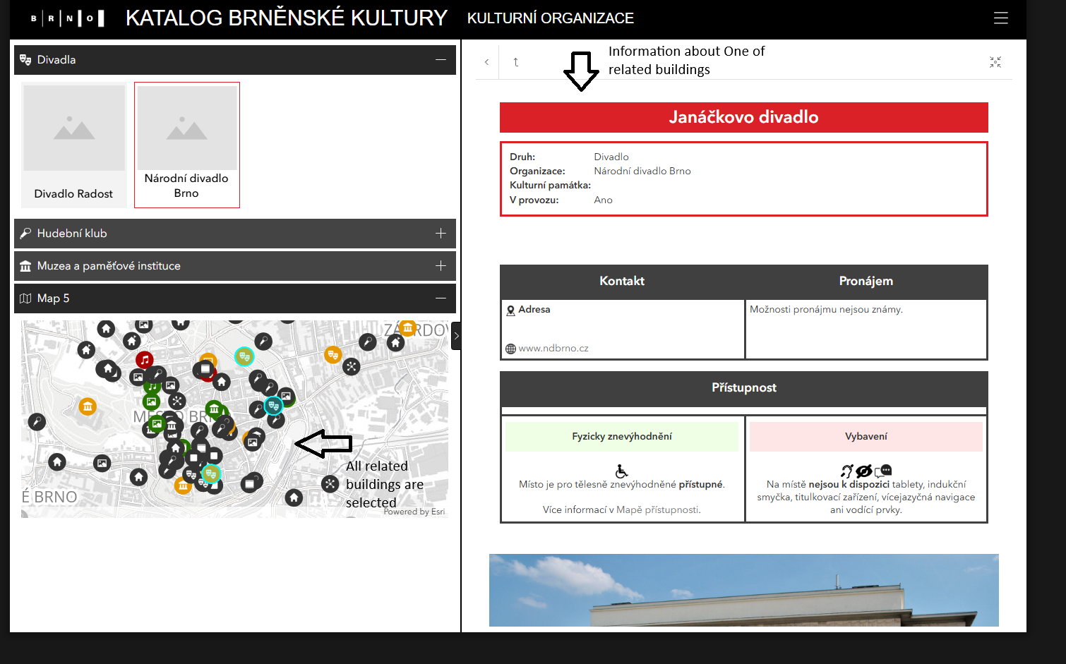

In my example I have table and 1:n related feature layer. I have list with organization and in map I have their buildings. When I select organization in list, feature info show information about this organization and in map I select all buildings, which my organization has (by trigger from list). In Feature info I also have buildings by related records. So I click on one building and now in feature info is information about this one building, but in map I still have selected all buildings and it is confusing.

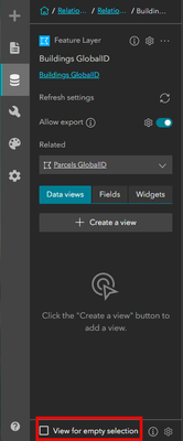

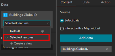

I think you can use the selected features view in the Feature Info widget:
Make sure that "View for empty selection" is checked for the Buildings layer.
Please let me know if this solves your problem.

I'm not sure, if I understand it correctly, but I don't think it works.
There is a problem with selection. If I click on the building (related record from pop-up), organization is still selected not building. So in the map I see all the time all buildings not the one, which I see in detail.
My question is about adding option to have trigger for choosing related record in pop-up (feature info).
In my app I finally use different solution with list of buildings (instead of related records in pop-up) filtered by related organization. Same filter is for map (because of framework setting). When i select building from list I open second view with feature info about building and map with all building of organization, but only the correct one is selected.
