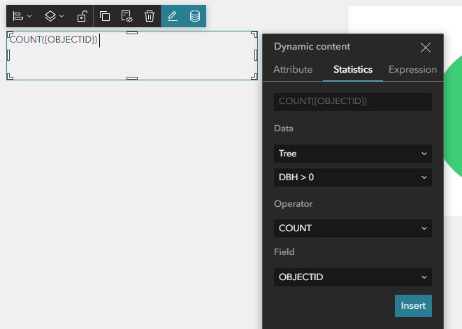

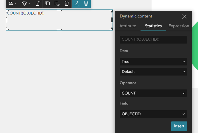

I am trying to show totals of different attributes for some tree data. For example, count of total tree sites, count of empty tree sites, and count of tree sites with trees.
If I connect to the default view of the data and then choose COUNT({OBJECTID}), it will display the total number of features.
calculating against defaultcalculating against default
works fineworks fine
But when I create a view and then try to do the same calculation looking at the view, it just shows the formula COUNT({OBJECTID}).
calculating against a viewcalculating against a view
Error when calculating the count on a viewError when calculating the count on a view
LRoberts_RDM
It turns out I'm getting a 403 error. The image below shows two text boxes, both looking at the same source data. The only difference is the bottom text box has is looking at a view of the original data and the top is looking at the default. For whatever reason, the view is throwing a 403 error. I'm working in AGOL, but the data is a referenced layer coming from ArcGIS Enterprise and added to AGOL as a referenced layer.
