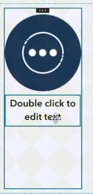

@SaadShahzad, @JeffreyThompson2 I'm having the same problem. I encountered this a couple of weeks ago. I tried starting with a new text box. This GIF is the result. The text reverts back to the default: "Double click to edit text."ExB_Text_Error.gif

Clicking where you specified did not save the edit either. It seems to only occur when it's a text box within a Card. For other text boxes throughout the Experience, I am able to edit and save those texts.
