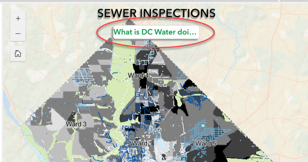

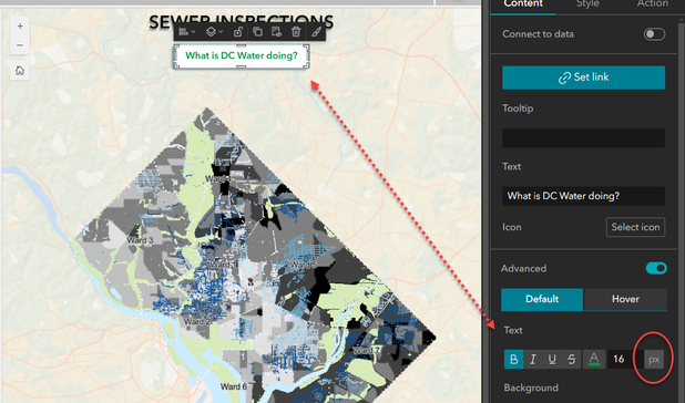

Hi Wei
There isn't an option for buttons to have the text size be by %. You can only set via px.
This is in edit mode. you can see that the text can only be edited by px
This is what you see in view mode. if the browser is not at 100%, the size of the txt is not resizing to fit the button.
