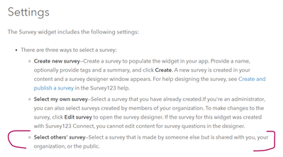

The documentation says that you can embed a public shared survey in the survey widget in experiencebuilder. But the menu only shows the surveys inside my organisation. Ex. I can't find a survey made by esriTraining there is shared with public.
Is it a error in the documentation or in experiencebuilder?

I can confirm it is a known limitation that you can only select/embed public surveys belongs to your org in the Survey widget currently. You can use the Embed widget as a workaround for now.
We have an issue in the backlog, please feel free to raise an enhancement ticket to Esri Support to help prioritize this work.
I will contact the doc team to remove ambiguous from the doc topic.

I'm seeing the same thing - can only view surveys within my organization, and the docs do seem ambiguous. I would recommend opening a tech support case to see if an enhancement might be considered.
https://doc.arcgis.com/en/experience-builder/latest/configure-widgets/survey-widget.htm

The doc topic has been updated to the following:
Select others' survey—Select a survey that is made by someone else in your organization and is shared with you, your organization, or the public.
