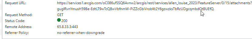

I captured a network traffic of querying attachments, but it did not include the `returnMetadata` parameter.

I think you have to work on a custom widget with JSAPI to achieve the image metadata then.
The popup or FeatureInfo widget does not support that.
