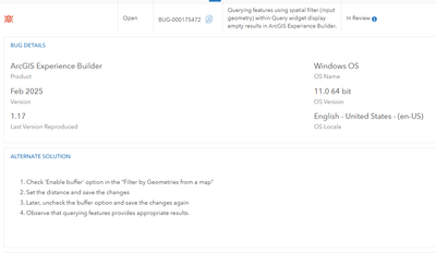

Brian_McLeer
MVP Regular Contributor
I submitted a case for this, and I think they created the BUG from my case.
https://my.esri.com/#/support/bugs/bugs?bugNumber=BUG-000175472
Syvertson
When I click on your link I do not see a bug, so it must not be publicly viewable.  In your screen shot it shows "in review" even though the bug is from February.  Also, I notice that the "alternate solution" is listed.  Did that alternate work for your situation, because it did not make any difference in my situation.
