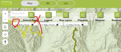

There might be some improvements possible with the map (labels, optimize layer drawing, etc) but it appears that something isn't quite right with the way this experience has been built. I get broken image icons and the options overflow.  There's two basemap options, two layers on/off. three associated surveys. Honestly I'd recommend taking a huge step back and redesigning the experience to be much more basic. If it's designed for the public it needs to be insanely user-friendly and intuitive. Less interactivity and a more guided approach may be better. e.g. have a help button that opens into a new tab for feedback. Get rid of list page. Consider just a map in this app, then have a separate app for the scene that can be specific for exploration. Maybe a Dashboard would be better - it would be good to have interactivity to filter by elevation gain or distance. Elevation widget can go to pop-up...
Not meaning to be critical - there's some clever stuff in there - but in my experience simplifying the app will make it perform better and align it more to the intended audience and usage.
MaxMolello
Since my post of separated the scene to a new page, so performance on the map now is the same in the webmap and experience builder. What size screen or device did you load it on, it looks like a tablet? I have not cleaned up the view for that size device, it's should look much better on a computer or phone.
