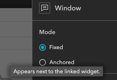

Have you tried the anchored window? That is designed to appear next to the linked element, like a button widget:
GDipublisher
Thank you for the reply, however I was searching for an ExB source way to do this, through JS or TSX.
