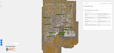

MeganWirth
When I include the URL parameters, it does not include the map extent. Am I missing something?!
Results:

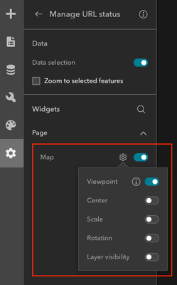

Shen_Zhang
Hi @MeganWirth - did you turn on Viewpoint for the map widgets? You will find map URL parameters adds to the app URL when the map extent changes at runtime.
Map extent is remembered in this URL so that you can share it with other folks.

MeganWirth
That was exactly the problem! Thank you
