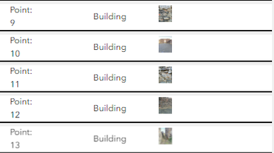

This is the layout of my custom widget using object IDs and displaying small attachment previews:

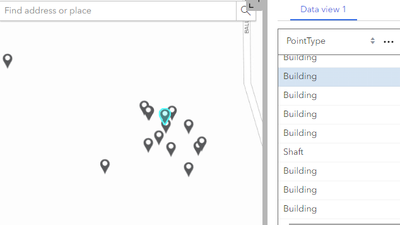

I want to be able to add an <a> to each row in here so that it acts like the table widget as shown here:
The idea is to have the map update to a zoomed view using the ObjectID and highlight it in the table too.

You can add an onClick event to the JSX element in your list. In the function triggered by the click event, use a goTo() function to zoom the map.
https://developers.arcgis.com/javascript/latest/api-reference/esri-views-MapView.html#goTo
