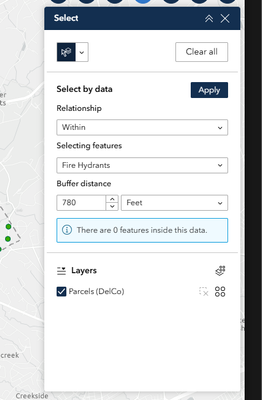

I want to be able to select parcels (from an open data source) that are within a certain distance of all the points in a point layer (HFL that I own). Then I need to be able for the user to export the results. Is there a way to do this either using Filter, Query, Select, or Near Me widget? The user will always want to use all the points in the HFL, not a selection of it. I tried using the Query widget but it didn't return any results. What is the easiest way for the user to just define the buffer distance and export the results?

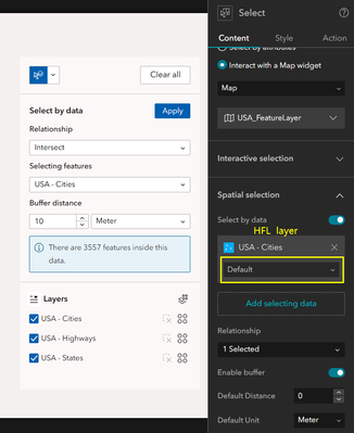

Hi @apgis16,
Which relationship are you using? Using the Select widget and configuring it as shown in the image below, can it meet your needs?

apgis16
It says there are 0 features inside this data

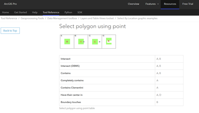

Hi @apgis16,
"Within" can't be used to select polygon using point. You could use these relationship as below.
https://pro.arcgis.com/en/pro-app/3.3/tool-reference/data-management/select-by-location-graphical-ex...
Thanks,

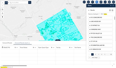

apgis16
I changed it to use intersect and the Query widget (because I need to select the full parcel layer, not a filter of the parcel layer that is in the map). How come the results say 5,723 but when I "add it to table", it says 5,277. When I run Select by Location in Pro using the same buffer, the result is 5,278. The total parcel records are 5,745.
