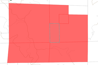

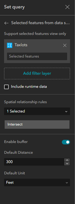

I am configuring a Query widget for our users, so that they can select taxlots from a feature layer, and then identify neighboring taxlots with a buffer (Intersect relationship). Is there a setting to make the buffer appear visually on top of the features? If not, perhaps I can submit this as an idea, as being able to visually see the buffer would help with our analysis considerably.
The settings I have configured to perform this buffer. It is enabled, but doesn't appear on the map.The settings I have configured to perform this buffer. It is enabled, but doesn't appear on the map.The selected taxlot feature, and its neighbors. The buffer is performing correctly, but I have no way to see it.The selected taxlot feature, and its neighbors. The buffer is performing correctly, but I have no way to see it.

Yes, you are correct. The Selected Features From A Datasource option in the Query Widget does not show a visual representation of its buffer. There is one with the Drawn Graphic option.
You may consider using Near Me instead. There is a lot of overlap between Near Me and Query and Near Me shows its buffer area.

Update -- Solved using Developer Edition!
@JeffreyThompson2 you were right that the visual buffer was missing from the "Feature from Data Source" mode. With some help from Claude, I was able to modify the Query widget's source code to add the buffer graphic. I'll try to explain as best I can.
