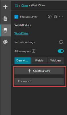

Hi @Anonymous User ,
If you don't want to remove other features from the layer, you can create a view and apply search on the data view.

ShengdiZhang

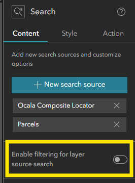

DerekFarr
If you have not found an answer to this yet. This is what worked for me.
The Enable filtering for layer source search button was switched on. turn it off and it wont turn off the layer upon search of that object. This worked for me, i can not guarantee it will work for you.
