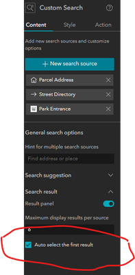

Do you have the "Auto select the first result" option turned on?
I have discovered that when this box is checked the search widget will ignore the user's chosen data source and return data from the first data source with a valid response.

BuffaloCoWI
I do not have that selected, though I did try it while debugging. It doesn't work either way.
