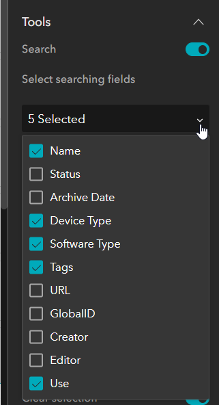

@ShengdiZhang solved this. One of the fields "Use" was selected for Searchable fields. This may be a restricted word, so once I disabled this, the search went back to its normal self. Thanks again for the quick action!

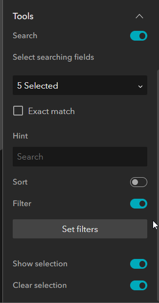

@ShengdiZhang It's not working at run time. It wasn't working from this afternoon. Previously it has always worked for me.

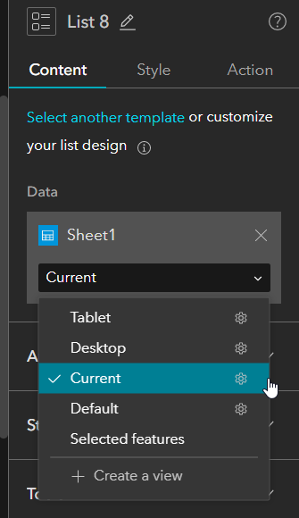

The only differences today are that I've changed the format from listing sideways to up and down. I've also changed the view to have a filter on it.
