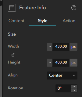

  1. Place your Feature Info Widget inside a Column Widget and give it a fixed Width in px. I used 400px.
  2. In the Feature Info Widget, use Align Center and a fixed Width wider than the Column. I used 430px.
Try playing around with something like this and see if you get something presentable.

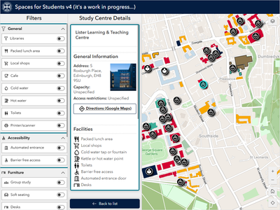

Thanks @f92k and @JeffreyThompson2.  I like your suggestion, and I've had a go, but I can't get something that I'm totally happy with:
It's annoying how the main body of the Feature Info panel has more padding applied than the header, so applying negative margins to get something looking good means the header ends up getting chopped off.  Oversizing the Feature Info widget on the right, to hide the extra padding, means the vertical scroll bar isn't visible, which isn't good as it's easy to get a situation where you wouldn't know it was there:
Thanks for trying, I think I'm going to log a support request/bug though because the extra padding is unnecessary and could be significantly improved by removing it.

Thanks for the suggestions @f92k.  Certainly removing the title from the popup and adding a Text widget sorts the problem of the header getting chopped off when the Feature Info widget is wider than the containing column (see below).
But I'm having to set the width of the Feature Info widget so that it's wider than it's container to try and hide all the extra padding.  So, even with the height of the Feature Info widget set to 'auto', this means the vertical scrollbar is also not visible because it's overflowing the container (the grid column in this layout):

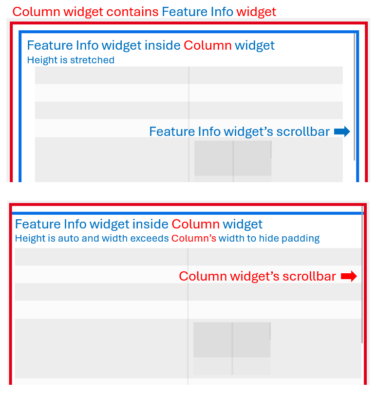

f92k
I am not familiar with the Grid widget so I can't speak to that.
The Column widget is scrollable when its content exceeds its size. Therefore, place a Feature Info widget inside it and set the Feature Info widget's height to auto. The container in this case is the Column widget, and its scrollbar will be visible if its contents (Feature Info widget) exceed the container's size.

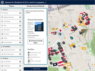

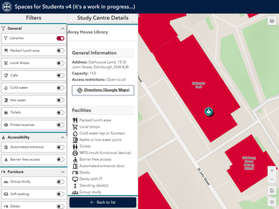

Here is an example illustrated.
MappyIan
Thanks @f92k, that's really helpful.  I just checked my Experience and I'm using a Section inside a Column in a Grid layout.  Doing what you've done above doesn't display a vertical scroll bar for me, so I guess that's a difference between a Grid layout and a Column based layout.  I'm probably going to need to modify my Experience to use Columns anyway (because there are no controls on the widths of columns in Grid layouts >:() so will see if I can get something that works using the technique outlined above.  Thanks for taking the time to explain.
