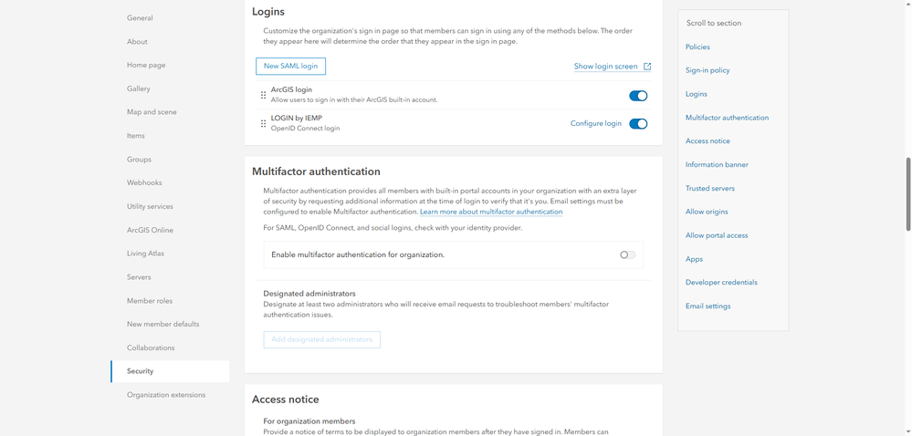

I haved added the company's openID to ArcGIS Portal so that users can login by both built-in account and openID. But when user open the app url
https://xyz.yyy.com/portal/home/item.html?id={app id}
The url is forwarded to the long url.

Can you please take a look at these two bugs to see if they match your issue or the workaround helps?
Check if you have a reverse proxy/Web Application Firewall: the block is due to the HTTP URL length exceeding the global limit, which you may be able to increase for a single application or in the global policy setting.
Check whether you have any settings that enable short URLs.
From the Keycloak Admin console, in the provider's advanced settings, you must enable the "Requires short state parameter" option. This provides a solution for the client when connecting to ArcGIS Experience Builder.
