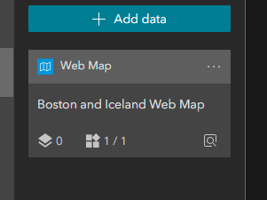

Hello all, I am building an experience builder app using a web map I created. It has one layer only that I created using a CSV table with LAT, LONG coordinates. I am trying to add things like table, filter or query and am receiving this note: "No added data can be used"

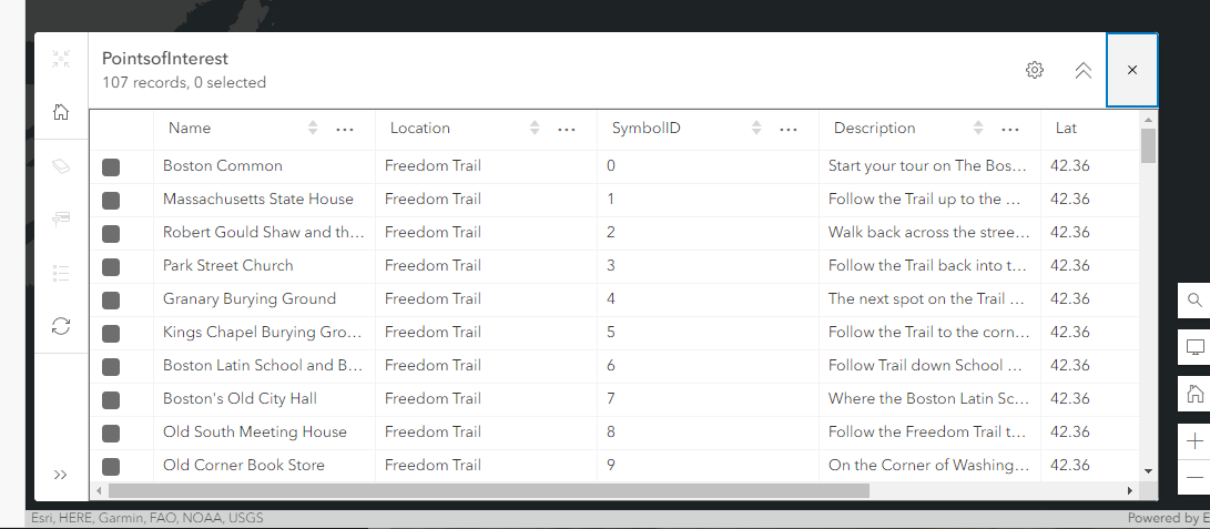

There is a working table of my data in the web map so I'm not understanding why it isn't isn't to use it for these widgets? Any help or thoughts would be appreciated.
