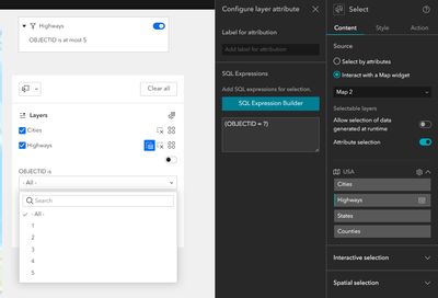

I am using a query widget to query the streets (by attribute) with a spatial filter for regions. This works when I use the select widget to select the regions (by attribute). But I would prefer to use the filter widget to select the regions because it is much simpler and less error prone for the user.
- Is it possible to use the filter widget with the spatial filter of the query widget? Wasn't that possible with the Web AppBuilder? I couldn't get it to work, the query widget ignores my selection in the filter widget. How should I configure the triggers/actions?
- Alternatively, if the filter widget does not work: How can the look and feel of the selection widget be made simpler and more user-friendly? I mean, the filter should always be active, the region layer always selected and the drop-down list always visible?

Select widget supports spatial query. Toggle on Attribute selection and then configure layer attribute.

I was able to select the region and street layers by attribute in a selection widget.
But how can I filter/select only the streets that are located in the selected regions (spatial intersection)? I have configured a spatial selection by region (selected features), but this has no effect.
Can I write the selected features (streets) in a (temporary) result layer (from the selection widget) like in the query widget? So that I can get the attributes of a feature in a pop-up? If the features are just selected, the selection disappears as soon as I click on a feature.
