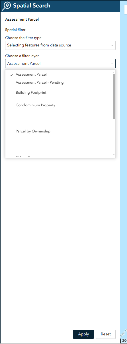

Again working with the Query widget in Experience Builder and trying to build spatial searches for all necessary layers in a Web Map using references Map Image Layers in our Portal shared from ArcGIS Pro. Have only built for one layer so far and selected several layers to "Filter By" (displays as "Choose a filter layer" when using the widget). I've noticed that some layer labels do not properly display initially in the "Choose a filter layer" drop down when I was testing the Experience Builder. Checked if it was something to do with differing coordinate systems, layer visibility, pop-up status, or any pattern between the layers whose labels will not display and I could not find any pattern that made sense, appears to be entirely random. Once I click on some of the blank layers in the drop down a few times, eventually the labels start to display properly but when I refresh this issue occurs again, with the same resolution of having to randomly click blank labels several times until they finally display properly. Has anyone else had this issue or know how to resolve it? This makes for a pretty poor and unprofessional product for our end users who will use this Experience Builder once in production.

Could you let me know which version of ExB you are using? Providing a reproducible sample app would be helpful. Thank you!

@TianWen hi, we are using Experience Builder on Enterprise 11.3. I put a service request in about this and I believe it has since been logged as a bug or will be soon.
