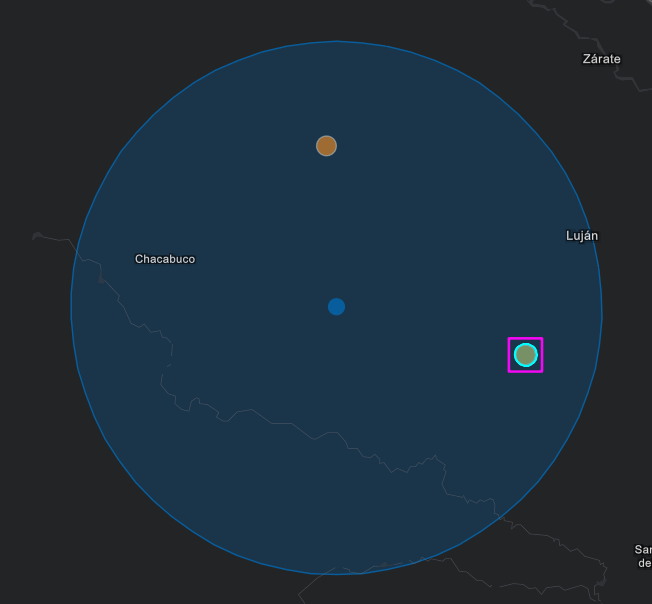

In the data layer when you're setting up your Near Me analysis, there is an option to filter to a subset of records. One of the options is "Selected Records" (highlighted in red in the screenshot below, using a Spanish interface because of my personal setup). If you use this option it should give you what you're looking for. In the second image, you can see a Near Me analysis that only selects a highlighted record, even though it's set up to find all objects within the search radius.
