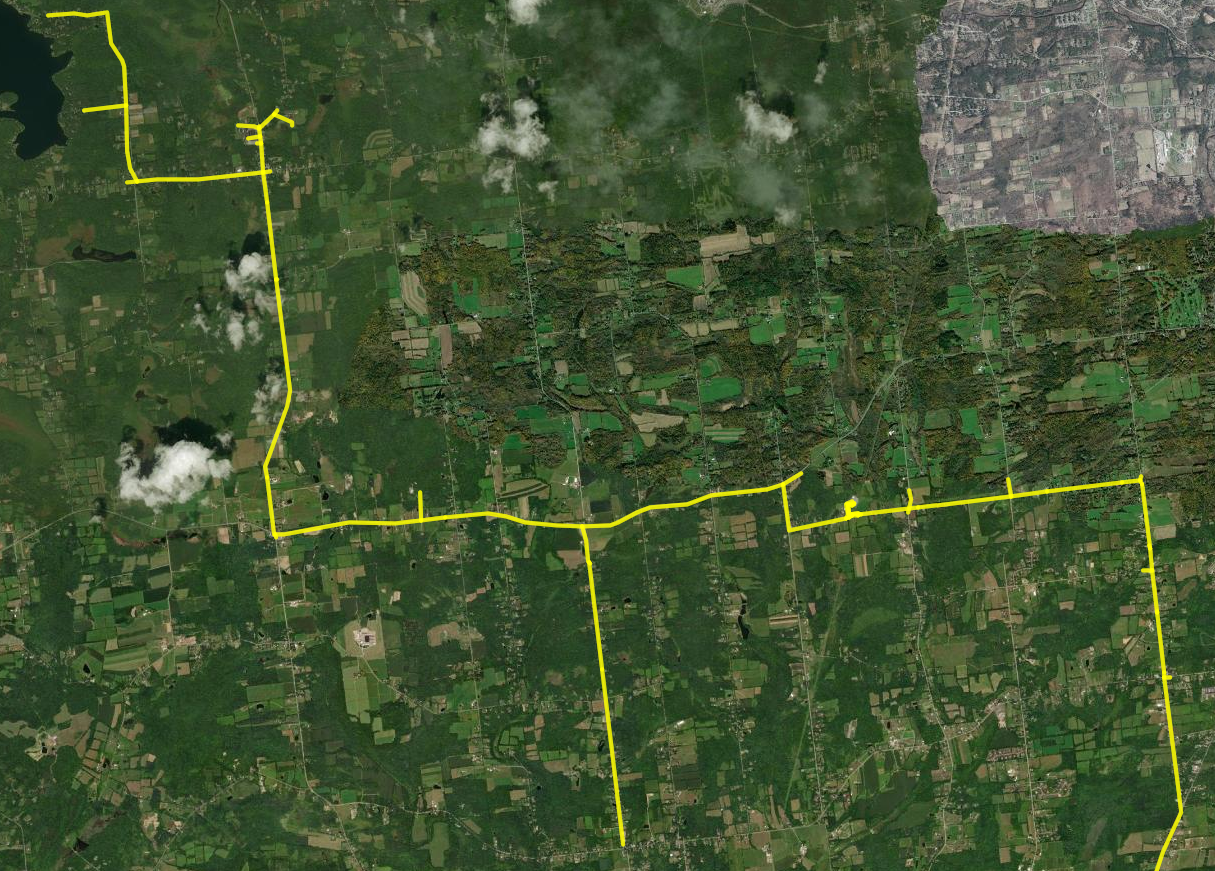

A problem with the Query widget I am seeing with various feature layers (regardless of geometry).
I issue a query, then do Show on Map to go to the selected features.  Then, when I click on the garbage can and reset the query, the highlight of the features remains.  Below is an example, showing the highlight of the selected polylines, even though the underlying feature layer is turned off.  I have to refresh my browser for the highlight to go away

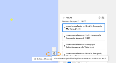

After the Show on Map results are populated inside the map, it can be removed from the map:
