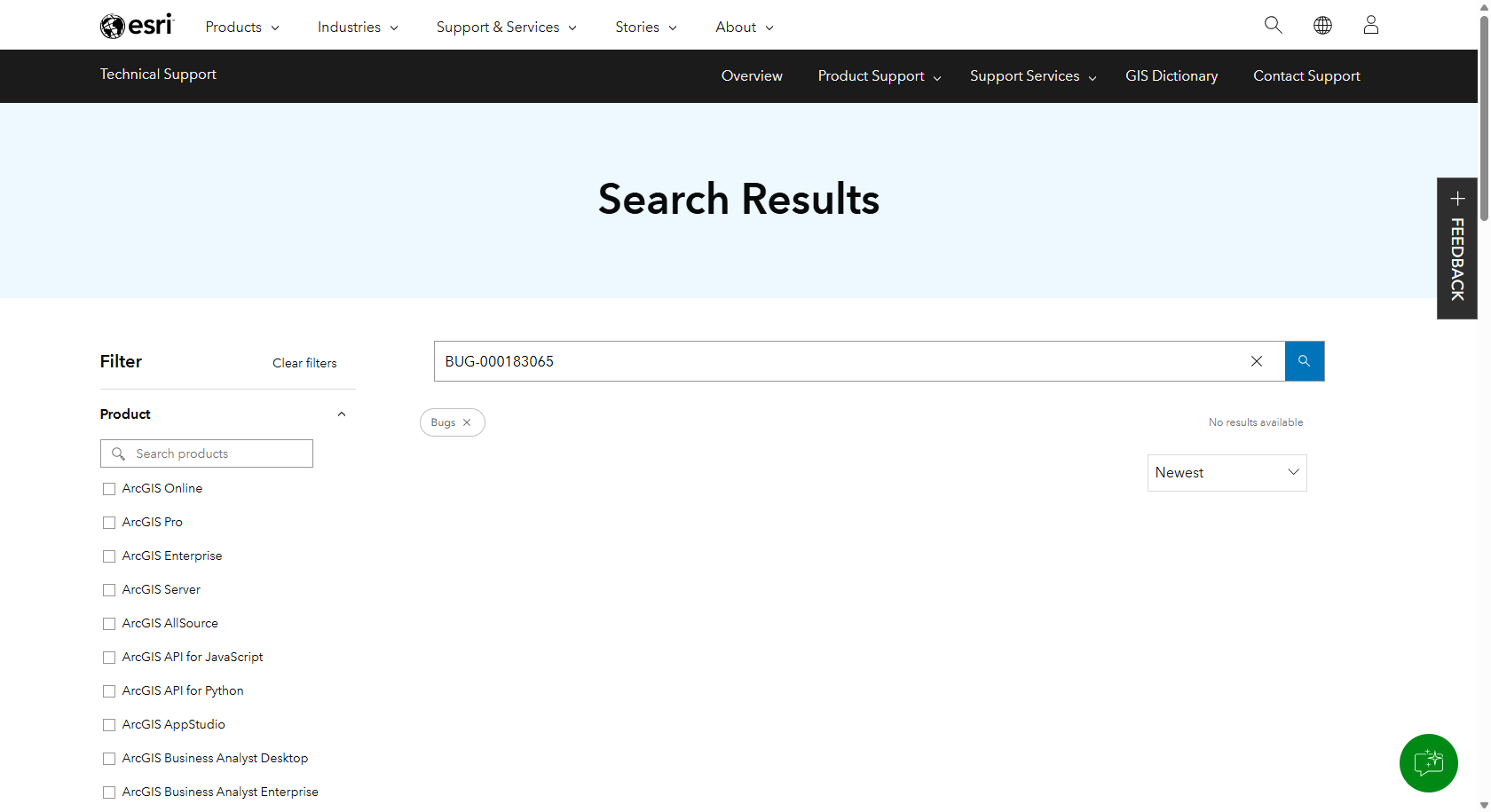

Hi @StephanieW, how can I view the details of BUG-000183065?  Searching for it on your support site doesn't return any results: https://support.esri.com/en-us/search?s=Newest&q=BUG-000183065&cardtype=support_bug_articles
