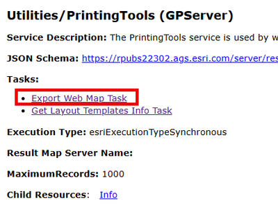

You are looking for ESRI Default Print Service URL?
ShengdiZhang

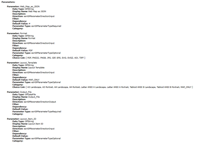

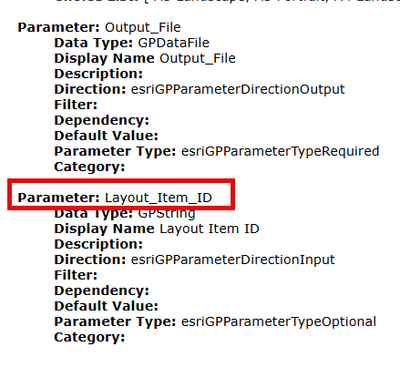

Hi @krantiYadav75 , From my testing, this feature works as expected in Enterprise 11.3. The issue may be related to the print service. Please check the print service—Export Web Map Task—to see if the parameter Layout_Item_ID is available.
krantiYadav75
@ShengdiZhang Layout_Item_ID is available.
