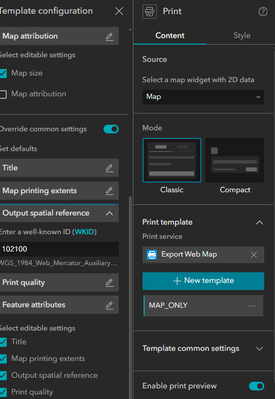

I'm looking to use a custom print template for the print widget.
This template would be based on a layout.
How would I go about setting a layout as a print template?
It seems I need to configure a print service but I'm not sure if I have or how to access an arcgis server which seems to be necessary in configuring a print service.
Would it possible to implement dynamic text in the template?
In the templates already given in the widget you can edit things like 'title', could something similar be done for a custom template?

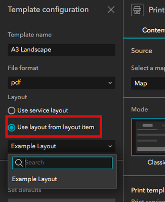

If you are using Enterprise 11.3, after uploading your layout file to Content, you can find it directly in the print template settings under "Use layout from layout item."

I have uploaded a custom layout template (pagx) but I cannot get the "Use layout from layout item" option to show up in the Template Configuration when adding a New Template within the Print Widget.  Am I missing a step?

Are you using ArcGIS Online? This feature is not yet available on ArcGIS Online.
If you also have ArcGIS Enterprise, you can connect the Print widget to a print service from your Enterprise environment. In that case, you should be able to see the layout templates from your Enterprise content.

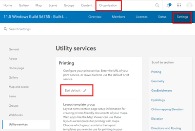

My organization just upgrade our Enterprise to 11.5 from 11.3. After our upgrade I am having this issue as well. At 11.3 I could easy add a custom layout template from right within ExB but after our upgrade the option doesn't show up at all. What's up with that? It was such a nice feature!
ShengdiZhang
Hi @ajohnson ,
I can confirm this is a bug, thanks for bringing it to our attention.
As a temporary workaround, you can go to your organization settings → Utility services, and set the printing service URL to empty.
Please let me know if the issue persists after trying this.
