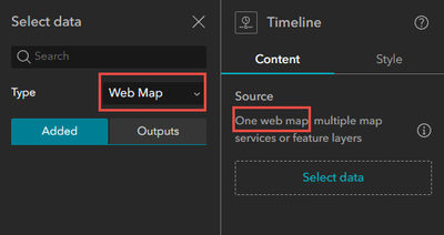

Berth68
Hi Shengdi,
My timeline is set to one webmap. Here is a example where the timeline filter is nog working with the print widget:
https://experience.arcgis.com/experience/04d7db62af0c45a0a9dc9005a683ceeb
I hope this helps you and if you need anything just contact me.
Regards,
Bert
Berth68
ShengdiZhang
Hi Bert,
We can reproduce your bug using the sample app. This issue stems from the time extent info stored in a group layer.
We'll address this bug in the next release. In the meantime, you can work around it by ungrouping the layer in the map.
Please let me know if you have any questions.
Thanks,
Shengdi

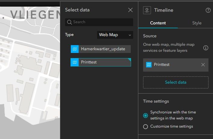

Berth68
Hi Shengdi,
Thank you. That worked for the sample webmap but unfortunately not for the actual webmap I am using. There are no groups in that webmap. I updated the experience with that data. Can you check this?
Thanks in advance,
Regards,
Bert
ShengdiZhang
Hi Bert,
We have identified the root cause of the issue, and this bug will be fixed in the next release.
Regards,
Shengdi
