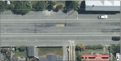

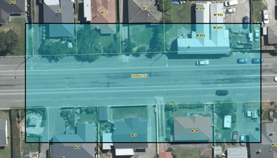

Hi @DennisWarnat , have you sorted out it on your end? I 've been facing the same issue.
I thought it was related to my Pro's map frame ratio and it matches exactly the printing widget print area box extent. Still, the PDF always come up with some extended areas beyond what the preview area indidcates.
  • Print Preview Area:
  • Actually Printed Map Frame in PDF:
This has been annoying, since this resizing also affects the size and placement of any drawing text box or line coming from the draw widget.
Has anyone tackled this?
