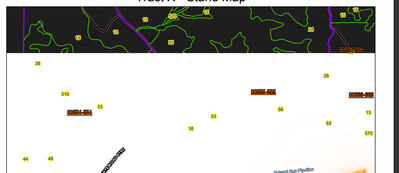

Anyone else experience printing problems in EB? Half of the pdf created shows a white background even when imagery or other basemap is selected.
AndreasEugster
Yes, we have the same problem...
We checked the sent payload... the webmap-json passed to the printservice has 2 additional "operational layers" of type "image".... don't know where they're coming from.
AndreasEugster
One step closer - in my case, having the "elevation-profil-widget" active will result in a white image covering the map when printing (adding white images as operational layers in the webmap_json). Having the "elevation-profil-widget" inactive in a lazy-loading-view works fine as long as it's not loaded.
I'm still trying to figure out the root since I can not replicate that behaviour with all webmaps... some work fine and printing works as expected.
@JoabelBarbieri is it the elevation-profil-widget in your case?
JoabelBarbieri
No but I think is another widget. If I close all the widgets I get it to print right. I just can't tell hundreds of users to do that every time or they will...you know..
