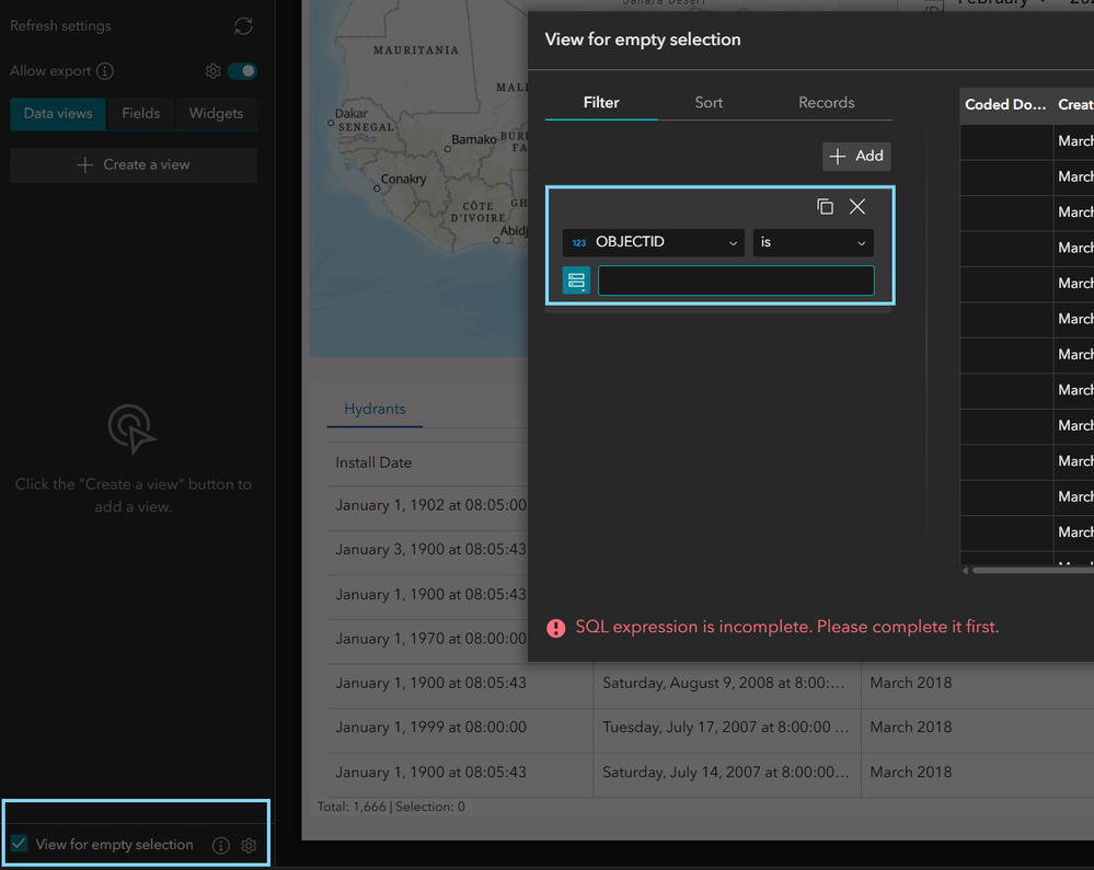

TonghuiMing
Hi @JohnRichardson
If that city logo is contained in any of your records, you can configure the “View for empty selection” in the data source settings as follows. Use the filter to point the empty to this record, and then you can see the desired effect:
If you're talking about adding a separate static image, we currently do not provide such a mechanism (ENH-000137935). But the image evolves Alt text and tooltip as well, so the data method is recommended. Let me know what your case is, and thanks for bringing this up.
