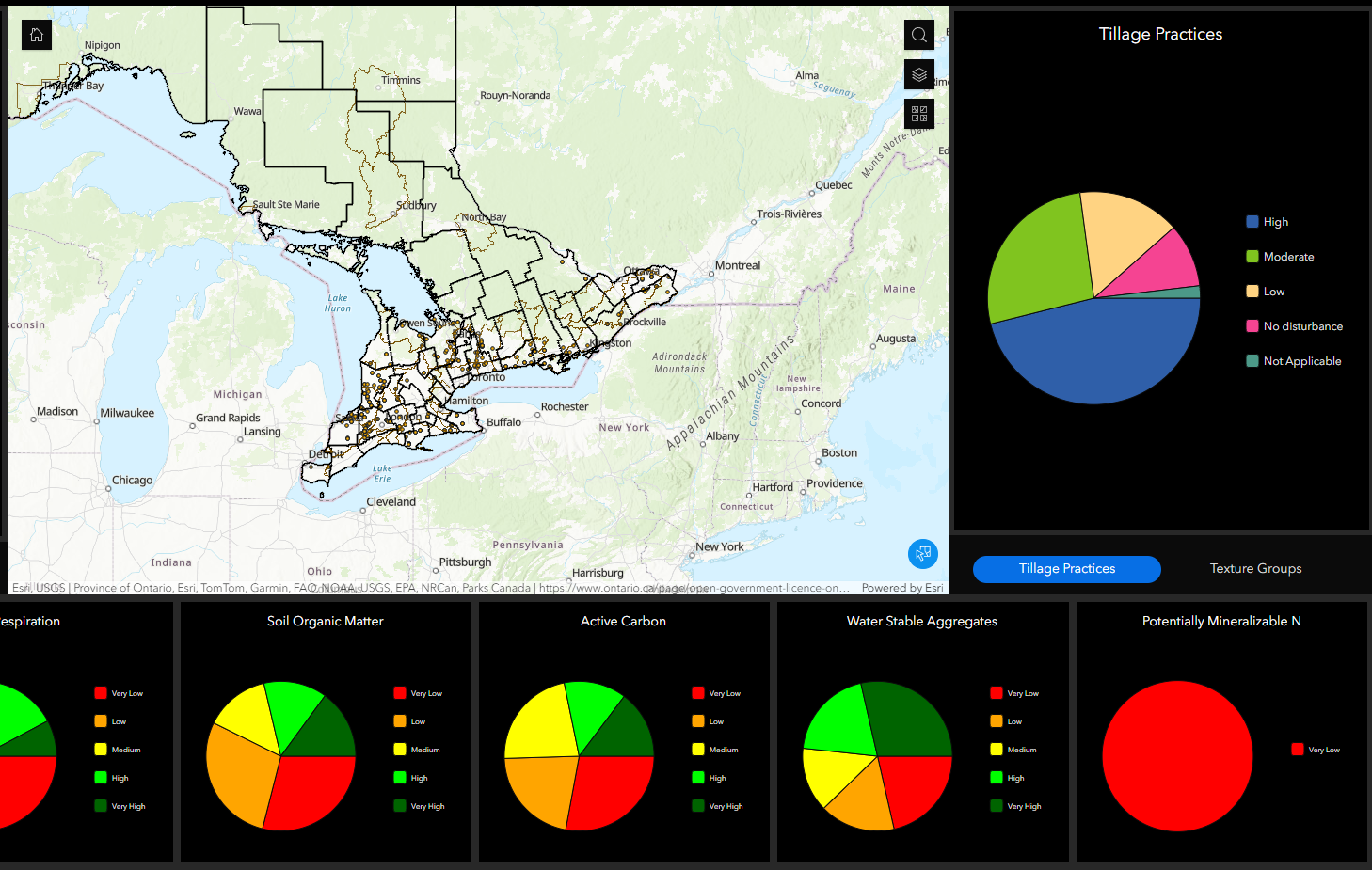

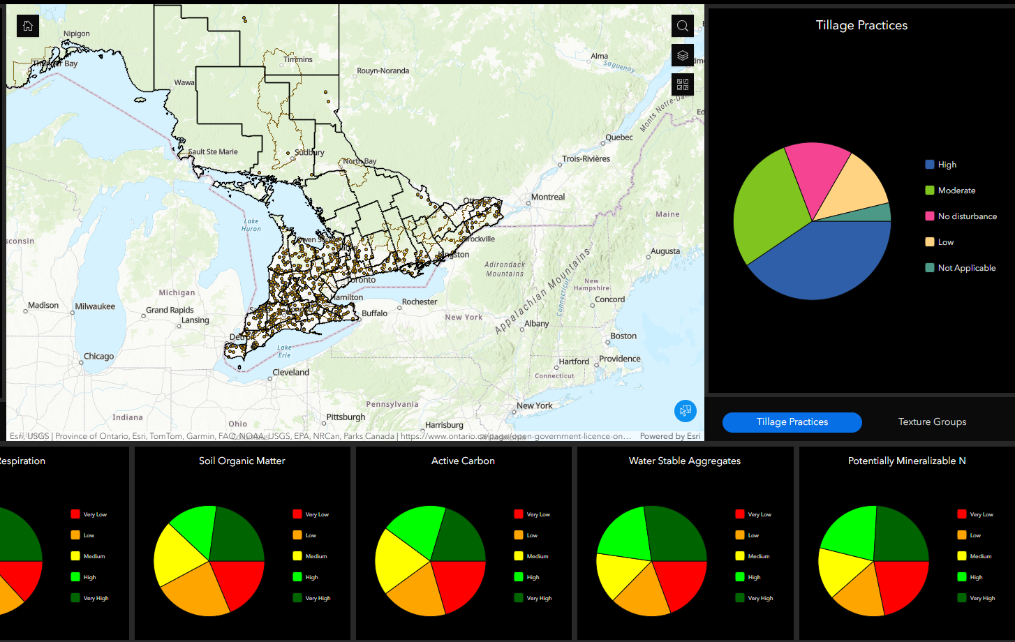

I have just discovered that my pie charts are not working properly in Experience Builder.  Before I could click on a pie chart wedge and it would filter both the map as well as other various charts.
Before wedge selection
After wedge selection
But when I click on the selected wedge to bring back the other wedges it is permanently stuck on that selection.  The only way to bring it back is to refresh the browser / Experience.
