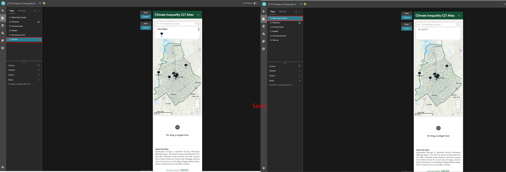

Hello Community,
I want to create a custom mobile layout for a page I made in the desktop editor. However, when I try to access it from the mobile editor, it disappears. In the mobile editor, when I try to select the page from the navigation menu, it still will not load.
Why is the page disappearing? How can I access it in the mobile editor?
Any suggestions are much appreciated.
Thank you,
Maya

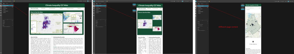

On small screen devices, the content of your “Atlas User Guide” page has been customized to use “Stories” page content. The page did not disappear, it loaded your customized page content.

MayaFleagle
https://experience.arcgis.com/builder/?id=1bf1e0d9b1484b778f656af3a8b1608e
The issue is with the page titled "Atlas User Guide".
Thank you for taking a look!
ZhenZhang22
Esri Alum
Hope it helps
MayaFleagle
Oops. I appreciate your help.
