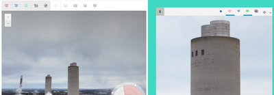

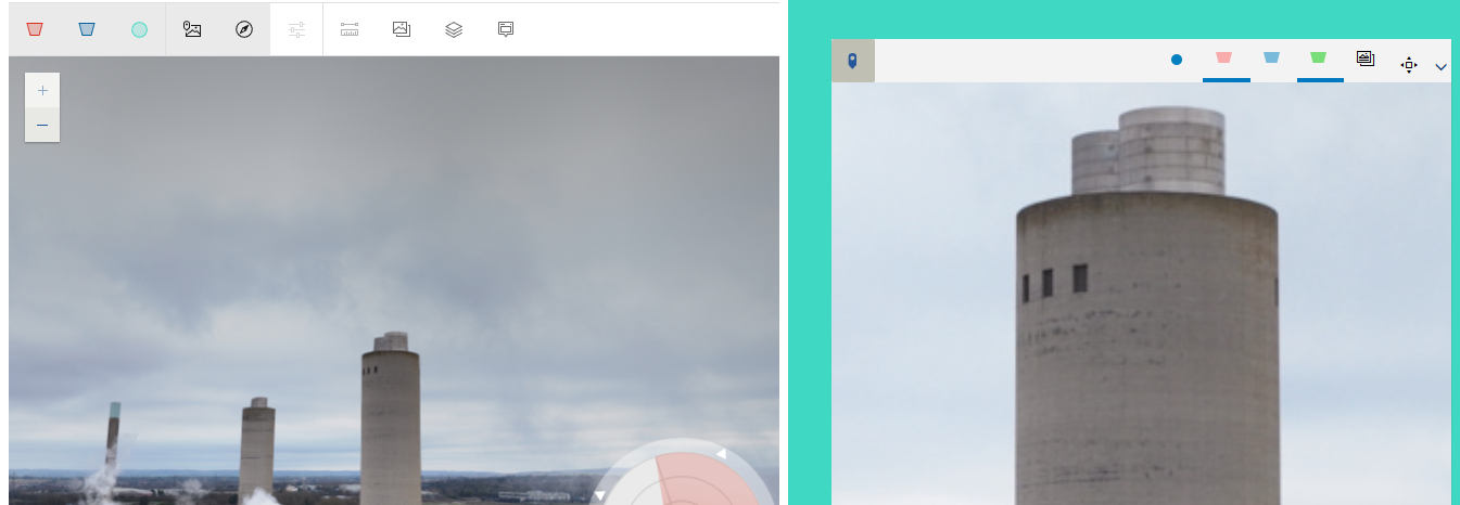

I'm testing out the new Orientated Imagery Widget in Experience Builder.
Below you can see the new one on the left and the classic on the right.
That is the maximum zoom on both as you can see that the classic widget is able to zoom in much more.
The new orientated imagery widget is based on the dataset and the classic widget is based on the catalogue for reference. As another note, I'd also suggest that the orientated imagery catalogue add on for ArcGIS Pro just actually become part of the product rather than an additional installation.
