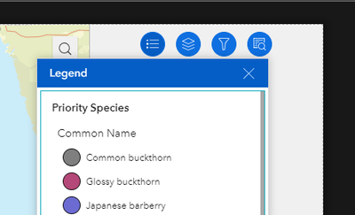

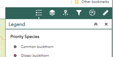

I am trying to get more familiar with Experience Builder since finding out there will be no updates to Web AppBuilder for 4.x JSAPI.
Is there a way to nest widgets similar to WAB? I would like to have something similar to this but using the widget controller is not allowing me to retain the resize and position of the widget popups.

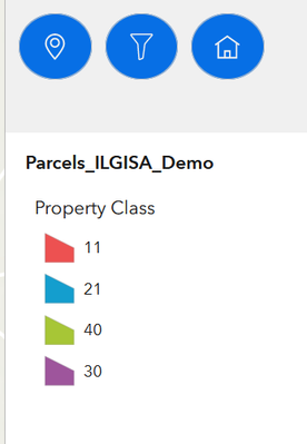

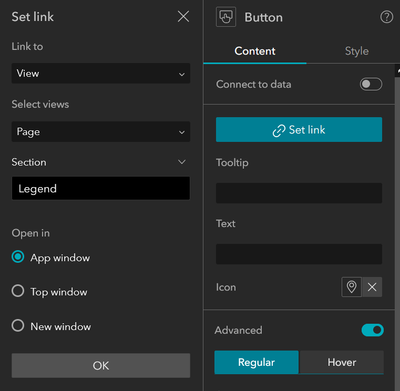

A widget controller makes sense for something like a header, or a series of widgets you want to be inside a map frame, but since it always makes floating windows for your widgets, it's not the best choice.
One downside of a View Navigator is that you lose the nice button icons. But try something like this:
  • Sidebar
    • Row
      • Buttons per widget, linked to corresponding section
    • Section
      • View per widget
- Josh Carlson

jcarlson
MVP Alum
Absolutely! A lot of the features of WAB like that can be replicated in EB. Check out using a Section or Sidebar (or both) to keep specific widgets contained and arranged in a different frame or window.
You could, for instance, have a floating window, within which you place a Section element, and then within different sections, your various widgets.
- Josh Carlson
Kendall County GIS
luckachi
I am currently working with the Pocket template with a sidebar. I've added a widget control to the right sidebar I've added the Legend widget, the layer list widget and a few other to the controller. I've tried to resize the legend widget and reposition it into the placeholder to the right but once I start switching between the widgets, the legend moves back to the original location.

jcarlson
MVP Alum
  • Sidebar
    • Row
    • Section
      • View per widget
- Josh Carlson
Kendall County GIS
luckachi
This is perfect and works great - thank you Josh!
