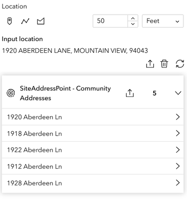

I'm trying to use the Near Me widget in Experience Builder in order to select features within a certain proximity, which works well. After the point is chosen though, when the results are returned, is there any way to remove specific results from the selection of the Near Me widget specifically? I want to download the results as CSV which the widget allows but it seemingly doesn't let us unselect a specific feature from the results before downloading the CSV.

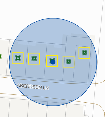

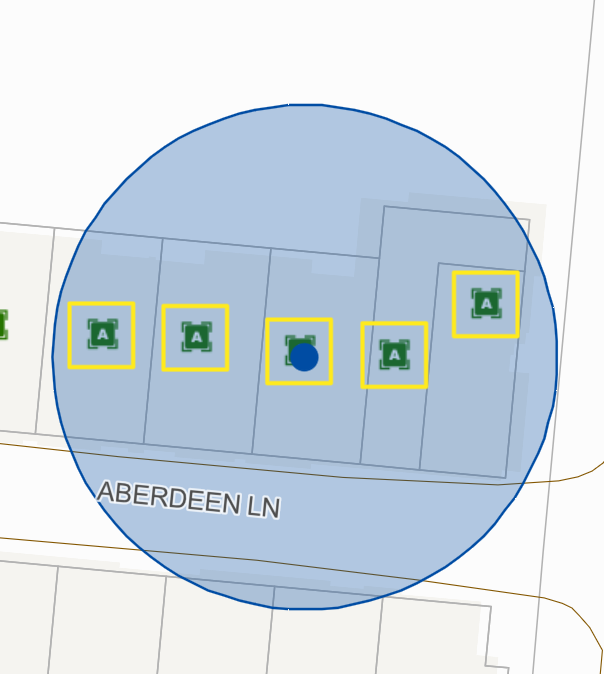

Visually, this is what it looks like after using the NearMe tool. Basically, what I'm asking is if there a way to unselect one of those selected features with the yellow squares.
Any help would be appreciated, thanks!

Hi @DhavalJani ,
So you want to remove one of the results so that does not get included in the downloaded file? If I understand your question correctly, unfortunately there is no functionality in Near Me to do that.
Why do you want to remove some results?
DhavalJani
Hey @AzizaParveen1,
We want to give the user the ability to unselect the features based on looking at separate fields of the features (maybe they decide a feature in the corner shouldn't be selected since it's of a certain type or the visual location on the map). It's for a mailing noticing list, similar to the Noticing Instant app. The widget itself shows what the image I attached, so I was hoping to ideally have the functionality for users to just unselect the ones they don't want. And then download the CSV. Is there another way this could be possible?
Thanks!
